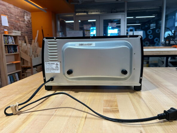

Pelonis Four Slice Toaster Oven Disassembly
    1. Pelonis Four Slice Toaster Oven Disassembly, Pelonis Four Slice Toaster Oven: step 1, image 1 of 2 Pelonis Four Slice Toaster Oven Disassembly, Pelonis Four Slice Toaster Oven: step 1, image 2 of 2
      • Remove the two 12 mm screws at the bottom of the toaster using a Phillips #1 screwdriver.
