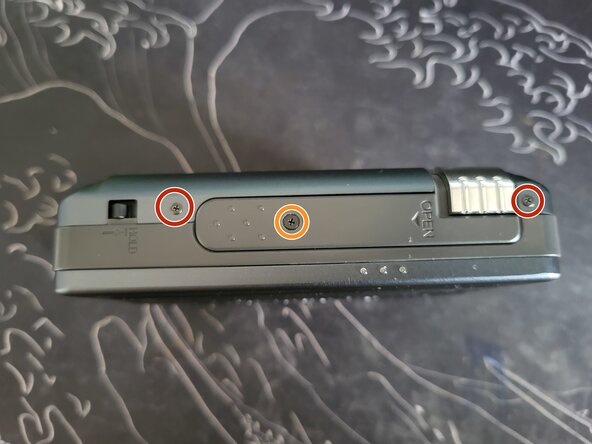

  1. Panasonic RQ-NX10 Drive Belt Replacement, Removing top case: step 1, image 1 of 2 Panasonic RQ-NX10 Drive Belt Replacement, Removing top case: step 1, image 2 of 2
    • Remove the following screws to remove the top case:
    • 2x 5mm P0 screws
    • 1x 3mm P0 screw (thin)
    • 2x 3mm P0 screws (thick)
    • Pull the case straight up to remove it.
