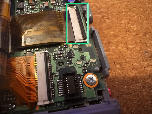

    5. Panasonic Lumix DMC-FS10 LCD Replacement, Daughterboard removal: step 5, image 1 of 2 Panasonic Lumix DMC-FS10 LCD Replacement, Daughterboard removal: step 5, image 2 of 2
      • Using a spudger on the bottom right side of the daughterboard disconnect the connector.
      • After removing the daughterboard gently remove the plastic layer on the logic board.

    6. Panasonic Lumix DMC-FS10 LCD Replacement, LCD removal: step 6, image 1 of 3 Panasonic Lumix DMC-FS10 LCD Replacement, LCD removal: step 6, image 2 of 3 Panasonic Lumix DMC-FS10 LCD Replacement, LCD removal: step 6, image 3 of 3
      • Remove the PH00 screw then flip the LCD to the right.
      • Remove the 3 PH00 screws that keep the aluminum plate the the camera then remove the panel.
      • Gently open the connector's black tension lock with a spudger and remove the LCD's wires. Now the LCD can be removed from the camera.
