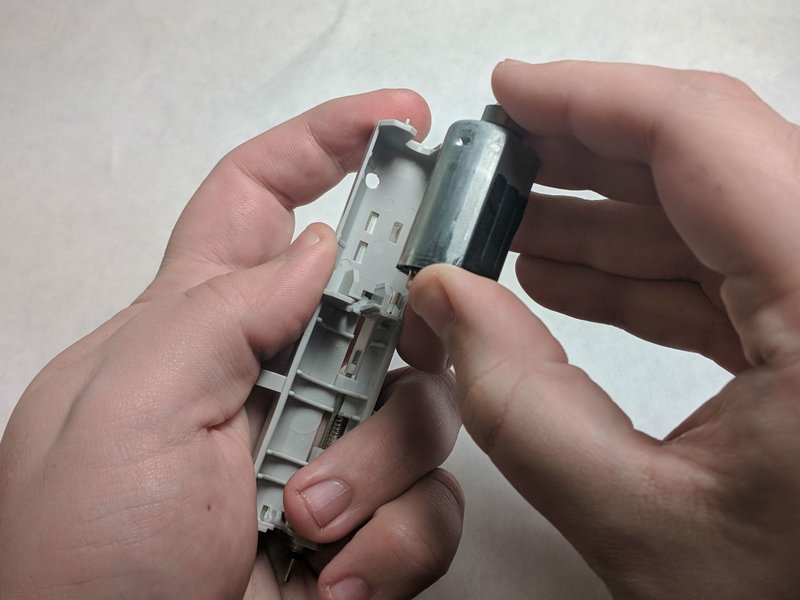

    2. Panasonic ES2207P Motor Replacement: step 10, image 1 of 1
      • Using pointed end of spudger, push on the motor through the hole in the back
      Ask FixBot
    3. Panasonic ES2207P Motor Replacement: step 11, image 1 of 1
      • Use your fingers to finish removing motor from frame.
      Ask FixBot
