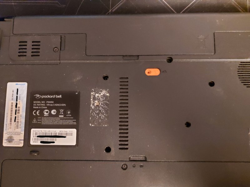

Battery replacement for the Packard Bell EasyNote TS11-HR-111UK
    1. Packard Bell Battery Replacement, Back Cover: step 1, image 1 of 1
      • Underside of the EasyNote TS 11 Laptop
      Ask FixBot
    2. Packard Bell Battery Replacement, Batter Location: step 2, image 1 of 1
      • This is the battery
      Ask FixBot
    3. Packard Bell Battery Replacement, Release Catch: step 3, image 1 of 3 Packard Bell Battery Replacement, Release Catch: step 3, image 2 of 3 Packard Bell Battery Replacement, Release Catch: step 3, image 3 of 3
      • Insert the tip of a ball point pen into the hole in the orange tab, move the pen all the way to the left as in the photo's.
      Ask FixBot
    4. Packard Bell Battery Replacement, Final Step: step 4, image 1 of 1
      • The battery pops up insert the replacement battery and push down on the corners until you hear a click. The battery replacement is done.
      Ask FixBot
Follow the steps and when you hear the click you have replaced the battery. As a side note I would recomend that you fully charge the battery first or until the battery light on the front of the EasyNote has turned blue.
