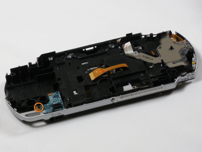

    1. PSP 2000 Audio Jack Replacement, Audio Jack: step 14, image 1 of 2 PSP 2000 Audio Jack Replacement, Audio Jack: step 14, image 2 of 2
      • With the logic board out of the way, remove the 4mm Phillips screw.
      • Carefully lift the headphone jack out of the casing.
      • Carefully lift headphone jack out of casing.
