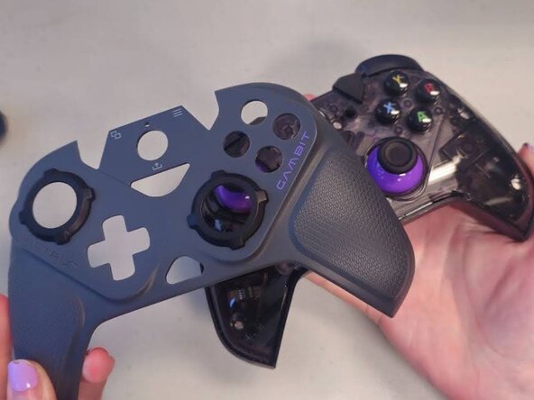

    • Grab the Directional-pad and pull it up & off the controller.
    • Grab the front casing by the indention at the bottom.
    • Using your fingers pull the front casing off the controller.

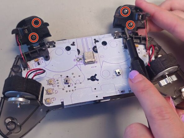

  3. PDP Victrix Gambit Prime Wired Tournament Controller Motherboard Replacement: step 3, image 1 of 2 PDP Victrix Gambit Prime Wired Tournament Controller Motherboard Replacement: step 3, image 2 of 2
    • Remove the four 6 mm-long screws from the triggers using a Phillips #000 screwdriver.
    • Remove the triggers.

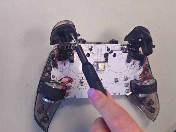

  4. PDP Victrix Gambit Prime Wired Tournament Controller Motherboard Replacement: step 4, image 1 of 2 PDP Victrix Gambit Prime Wired Tournament Controller Motherboard Replacement: step 4, image 2 of 2
    • Use tweezers to carefully disconnect the rumble motor connectors from their sockets.
    • Carefully remove the rumble motors from their slots.
