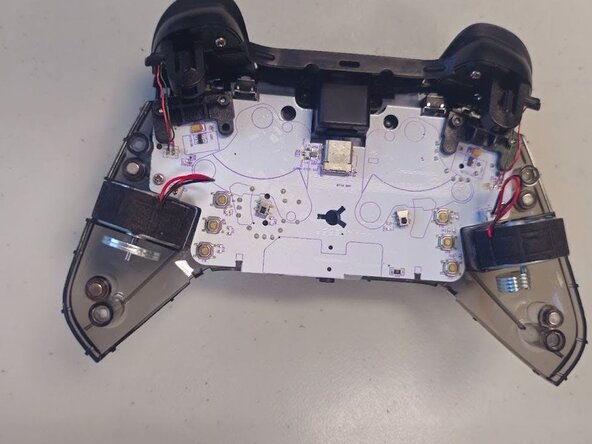

    4. PDP Victrix Gambit Prime Wired Tournament Controller Daughterboard Replacement: step 4, image 1 of 3 PDP Victrix Gambit Prime Wired Tournament Controller Daughterboard Replacement: step 4, image 2 of 3 PDP Victrix Gambit Prime Wired Tournament Controller Daughterboard Replacement: step 4, image 3 of 3
      • Use a Phillips #000 screwdriver to remove the two 6 mm screws holding the motherboard.
      • Watch for the Rumble Motors when you remove the motherboard.

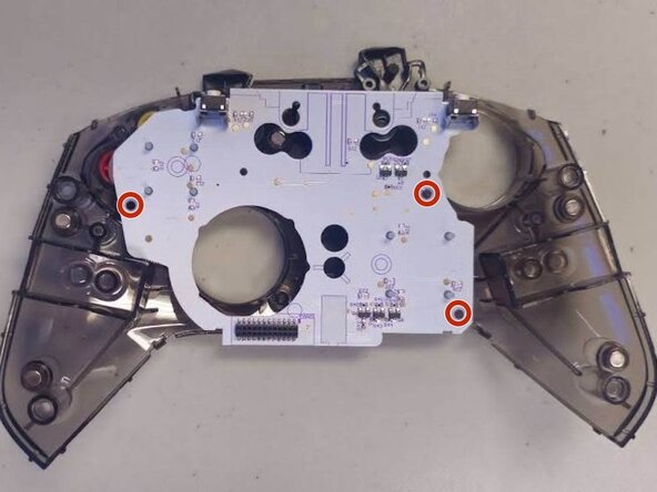

    5. PDP Victrix Gambit Prime Wired Tournament Controller Daughterboard Replacement: step 5, image 1 of 3 PDP Victrix Gambit Prime Wired Tournament Controller Daughterboard Replacement: step 5, image 2 of 3 PDP Victrix Gambit Prime Wired Tournament Controller Daughterboard Replacement: step 5, image 3 of 3
      • Remove the divider piece off of the daughterboard.
      • Use a Phillips #000 screwdriver to remove the three 6 mm screws securing the daughterboard.

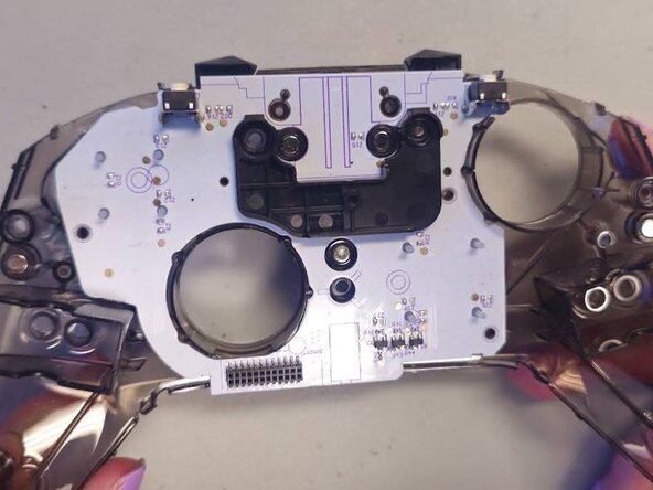

    6. PDP Victrix Gambit Prime Wired Tournament Controller Daughterboard Replacement: step 6, image 1 of 1
      • Remove the daughterboard.
