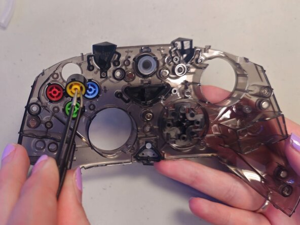

    12. PDP Victrix Gambit Prime Wired Tournament Controller Action Buttons Replacement: step 12, image 1 of 1
      • Pull off the four action buttons using tweezers.
