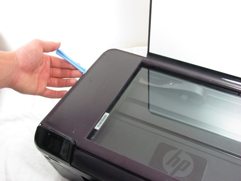

      • Unplug the device from any energy sources.
      • Lift the top cover of the scanner.
      • Use a plastic opening tool to remove the plastic frame surrounding the glass.
      Ask FixBot
    2. Outer Shell Disassembly: step 2, image 1 of 1
      • Carefully pull the frame away from the glass.
      • If it doesn't remove easily, use the iFixit Opening Tool again to pry stuck sections.
      Ask FixBot
