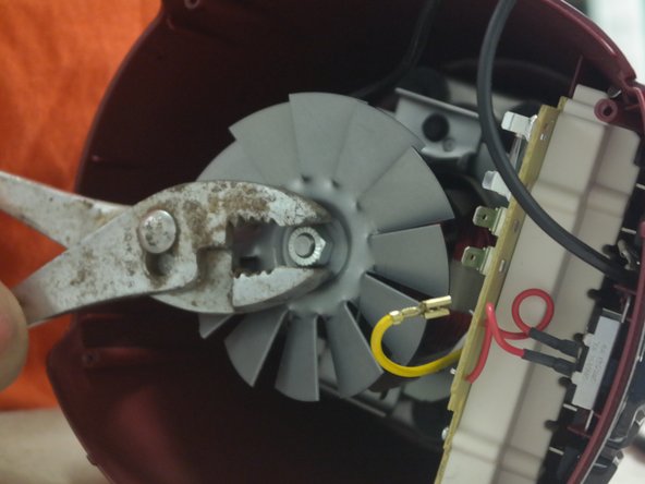

  3. Oster 12 Speed Classic Series Blender Motor Replacement, Remove Fan Blade and Spindle: step 3, image 1 of 3 Oster 12 Speed Classic Series Blender Motor Replacement, Remove Fan Blade and Spindle: step 3, image 2 of 3 Oster 12 Speed Classic Series Blender Motor Replacement, Remove Fan Blade and Spindle: step 3, image 3 of 3
    • The fan blade located on the bottom of the motor is sharp. Be careful when handling.
    • Squeeze and lock the vice grips on the spindle located at the top of the blender.
    • Using the other pair of pliers turn the bolt that secures the fan blade while holding the vice grips. Unscrew this bolt and remove the fan blade, washer, and spindle.
