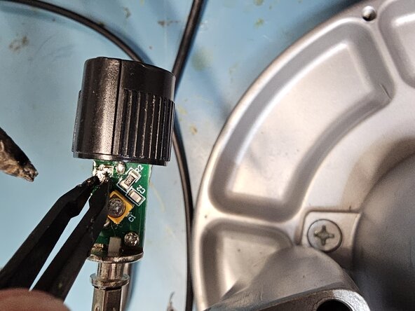

    5. Oscilloscope Probe SMD Resistor Replacement: step 5, image 1 of 3 Oscilloscope Probe SMD Resistor Replacement: step 5, image 2 of 3 Oscilloscope Probe SMD Resistor Replacement: step 5, image 3 of 3
      • Use tweezers to hold the new resistor in place.
      • Add solder to the tip of your iron.
      • Solder on one side of the resistor. After one side is fixed, you can stop using the tweezers, and then solder on the other side of the resistor.
      • You might accidentally burn the plastic on the probe while soldering on the resistor. Please ensure you have proper ventilation (fume extractor recommended!) to avoid inhaling the plastic fumes.
