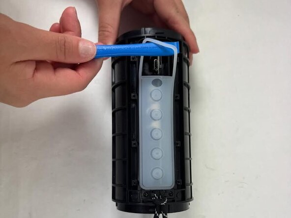

  5. Ortizan X10 Motherboard Replacement, Motherboard: step 5, image 1 of 3 Ortizan X10 Motherboard Replacement, Motherboard: step 5, image 2 of 3 Ortizan X10 Motherboard Replacement, Motherboard: step 5, image 3 of 3
    • Lift one end of the rubber button strip with an opening tool, then peel it away from the speaker housing with your hands.

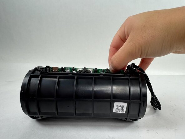

  7. Ortizan X10 Motherboard Replacement: step 7, image 1 of 3 Ortizan X10 Motherboard Replacement: step 7, image 2 of 3 Ortizan X10 Motherboard Replacement: step 7, image 3 of 3
    • Carefully shift the motherboard side to side to disengage it from the casing. JST connectors are attached—do not pull abruptly to avoid damaging the cables and connectors.

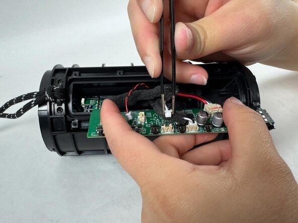

  8. Ortizan X10 Motherboard Replacement: step 8, image 1 of 2 Ortizan X10 Motherboard Replacement: step 8, image 2 of 2
    • Use tweezers to gently grip each JST connector and pull it upward to disconnect them.
    • Remove the motherboard.
