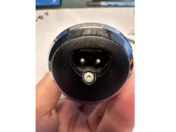

  1. Open the enclosure, Remove the bottom cover: step 1, image 1 of 2 Open the enclosure, Remove the bottom cover: step 1, image 2 of 2
    • To do this, unfasten and remove the Torx T6 screw
    • Then pull off the cover.

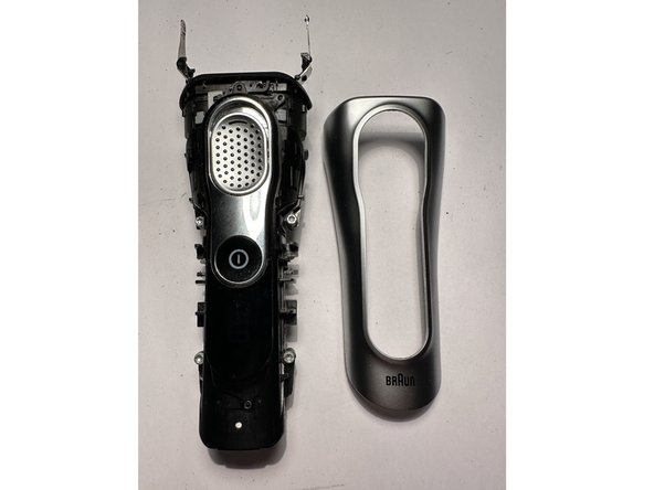

  4. Open the enclosure, Remove the front enclosure cover: step 4, image 1 of 3 Open the enclosure, Remove the front enclosure cover: step 4, image 2 of 3 Open the enclosure, Remove the front enclosure cover: step 4, image 3 of 3
    • Remove the front enclosure cover (outer panel). To do this, carefully pry the three side eyelets on the left and right slightly over the retaining tabs with a spatula.
    • Carefully lift off the enclosure cover.
    • Remove the switch cover. To do this, carefully pry the retaining tabs on the left and right over the retaining lugs.
    • Then lift off the exposed rocker switch at the top.
    • To do this, remove the four Torx T8 screws that are visible on the front left and right sides.
    • The tongue and groove opposite the case and cover can be pushed apart using a spatula.
    • The positive terminal of the 18500 cell points downward (shaving head at the top).
