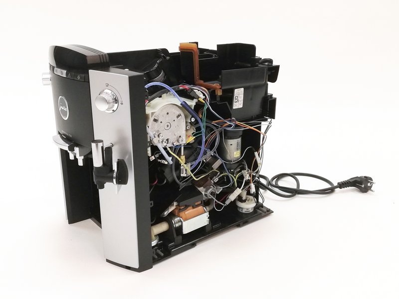

    • Clean the coffee machine before starting as well as possible and remove any remaining coffee bean debris, etc.
    • Pull the power plug before working on the coffee machine!
    • Never submerge the coffee machine completely under water.
    • Remove the drip pan, tray and container for used coffee,...
    • ... the water tank, ...
    • and the aroma protection cover.
    Ask FixBot
  2. Open Case: step 2, image 1 of 2 Open Case: step 2, image 2 of 2
    • One hurdle: the back is attached with four special oval-head screws. They look like rivets. To remove them, you need an oval-head bit. In a pinch, you can also use a good pair of pliers.
    Ask FixBot
  3. Open Case: step 3, image 1 of 2 Open Case: step 3, image 2 of 2
    • Remove the two T15 Torx screws from the coffee machine housing cover.
    Ask FixBot
  4. Open Case: step 4, image 1 of 2 Open Case: step 4, image 2 of 2
    • Remove the top cover of the coffee machine.
    Ask FixBot
    • Remove the panel from the right side.
    • Slightly lift the side panel at the back and then pull it out backwards with a little effort. Especially when disassembling it for the first time, the force required for this can be quite high.
    Ask FixBot
    • Remove the left side panel.
    • A light tap on the back of the recess for the water tank can help to loosen the side panel.
