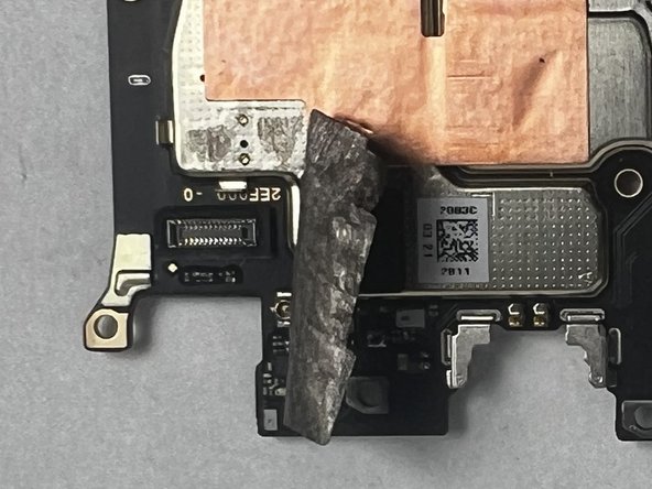

    1. OnePlus Nord N200 Motherboard Replacement, Motherboard: step 15, image 1 of 3 OnePlus Nord N200 Motherboard Replacement, Motherboard: step 15, image 2 of 3 OnePlus Nord N200 Motherboard Replacement, Motherboard: step 15, image 3 of 3
      • Place an opening pick or a spudger under edge of the two press connectors and pry straight up to disconnect them.
      • Make sure to pry under the edge of the connector itself, and not under the socket on the board. Otherwise, you risk permanently damaging the socket.
      • Work carefully: don't pry on or accidentally scrape any small, surface mounted components on the board.
      • To reconnect, align the connector carefully over its socket and press down with your fingertip—first on one side, then the other—until it clicks into place. Don't try to force the connector into place. If you're having trouble, reposition it and try again.
      • Don't press down on the middle of wider connectors until they're fully seated. If misaligned, the connector or the pins underneath can bend or break, causing permanent damage.

    2. OnePlus Nord N200 Motherboard Replacement: step 16, image 1 of 3 OnePlus Nord N200 Motherboard Replacement: step 16, image 2 of 3 OnePlus Nord N200 Motherboard Replacement: step 16, image 3 of 3
      • The black coaxial connector should be disconnected first as it is the ground connector.
      • Peal the tape up in the upper right corner of the phone to reveal the black coaxial cable.
      • To disconnect the black coaxial cable, slide a thin, ESD-safe pry tool or angled tweezers under the metal neck of the connector (as close to the head as possible) and lift straight up from the board.
      • When working with these connectors, it's key to always lift the head straight up. If pried on at an odd angle, you risk breaking the socket off of the board underneath.
      • Reconnecting these can be tricky. Use tweezers to hold the connector in place over its socket and gently press down with your finger or a spudger—the connector should "snap" into place. If you're having trouble, reposition the head and try again.
      • Don't try to force the connector into place or you may permanently damage it.

    3. OnePlus Nord N200 Motherboard Replacement: step 17, image 1 of 3 OnePlus Nord N200 Motherboard Replacement: step 17, image 2 of 3 OnePlus Nord N200 Motherboard Replacement: step 17, image 3 of 3
      • Slide a thin, ESD-safe pry tool or angled tweezers under the metal neck of the white coaxial cable connector and lift straight up from the board.
      • Use the tweezers to move the white coaxial connector away from the board.
      Ask FixBot
    4. OnePlus Nord N200 Motherboard Replacement: step 18, image 1 of 3 OnePlus Nord N200 Motherboard Replacement: step 18, image 2 of 3 OnePlus Nord N200 Motherboard Replacement: step 18, image 3 of 3
      • Insert an opening pick or spudger under the gold clip on the top right of the phone to unclip the motherboard.
      • Slide the opening pick under the edge of the motherboard to begin removing it.
      • Make sure all the wires and connector cables are disconnected before removing the motherboard.
      Ask FixBot
    5. OnePlus Nord N200 Motherboard Replacement: step 19, image 1 of 3 OnePlus Nord N200 Motherboard Replacement: step 19, image 2 of 3 OnePlus Nord N200 Motherboard Replacement: step 19, image 3 of 3
      • Remove the motherboard from the case.
      Ask FixBot
    6. OnePlus Nord N200 Motherboard Replacement: step 20, image 1 of 3 OnePlus Nord N200 Motherboard Replacement: step 20, image 2 of 3 OnePlus Nord N200 Motherboard Replacement: step 20, image 3 of 3
      • Remove the motherboard.
      Ask FixBot
