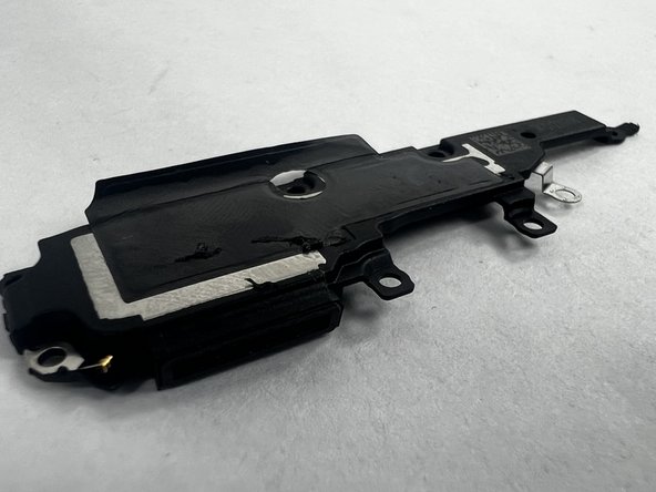

    1. OnePlus Nord N200 Battery Replacement, Speaker: step 11, image 1 of 3 OnePlus Nord N200 Battery Replacement, Speaker: step 11, image 2 of 3 OnePlus Nord N200 Battery Replacement, Speaker: step 11, image 3 of 3
      • Insert iFixit opening pick under speaker assembly.
      • Lift up the iFixit opening pick to pull out the speaker assembly out of its tray.
      • The speaker assembly should come out easily. If not, check if you missed a screw.
      Ask FixBot
    2. OnePlus Nord N200 Battery Replacement: step 12, image 1 of 3 OnePlus Nord N200 Battery Replacement: step 12, image 2 of 3 OnePlus Nord N200 Battery Replacement: step 12, image 3 of 3
      • Remove the speaker assembly.
      Ask FixBot
