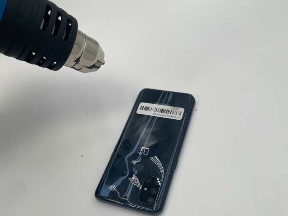

      • Use a heat gun to loosen the glue on the back cover.
      • Be sure to also heat the glue around the fingerprint button (this can be done at the end of this step to make it easier).
