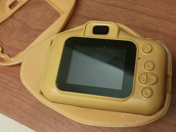

      • Make sure USB connector and the SD card are removed.
      • Crack free the adhesive around the seam of the potato cover.

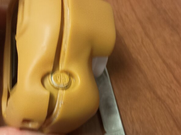

    3. Omega Mart Photato unsticking shutter/select button, Remove Side screw: step 3, image 1 of 1
      • Remove the side screw on the camera module.

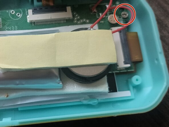

    7. Omega Mart Photato unsticking shutter/select button, Remove three mainboard screws.: step 7, image 1 of 2 Omega Mart Photato unsticking shutter/select button, Remove three mainboard screws.: step 7, image 2 of 2
      • Use the small Phillips screwdriver to remove the three screws holding the main board in place. (Ignore that the flex cable is attached in the photo, It was harder that way.)
      Ask FixBot
      • Take out the mainboard and set it aside.

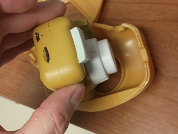

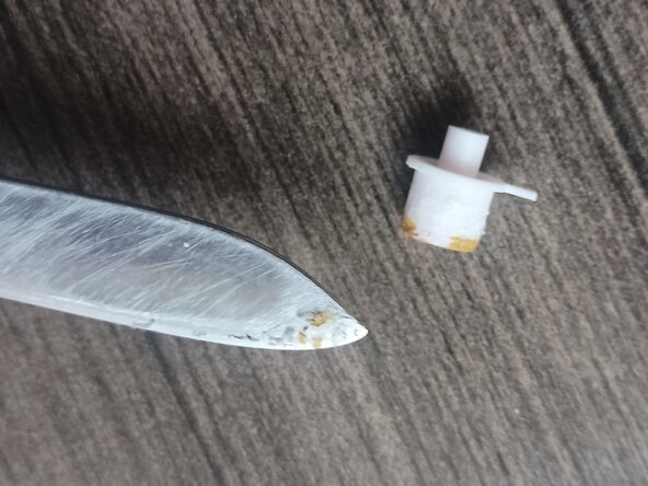

    8. Omega Mart Photato unsticking shutter/select button: step 9, image 1 of 3 Omega Mart Photato unsticking shutter/select button: step 9, image 2 of 3 Omega Mart Photato unsticking shutter/select button: step 9, image 3 of 3
      • Careful not to damage the display. Use the needle nose pliers to squeeze and force the bezel button out of the rear camera. You may have to break the glue with a knife. Be Careful not to cut yourself.
      • Scrape and trim the glue from the bezel button and the hole until, when inserted in the hole, the bezel button can move freely.

    10. Omega Mart Photato unsticking shutter/select button: step 11, image 1 of 1
      • Place the camera module back into the potato shell. Use a couple drops of super glue on the seams, BUT NOT THE BUTTONS!
      • IS POTATO!
