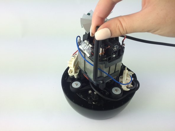

    • Remove the cup from the blender base.
    Ask FixBot
  2. Nutri Ninja BL450 Cooling Pipe Replacement: step 2, image 1 of 2 Nutri Ninja BL450 Cooling Pipe Replacement: step 2, image 2 of 2
    • Turn the blender over and unscrew the three 14 mm screws holding the slotted base in place. These are Torx Security bits (TR9) on some units.
    Ask FixBot
  3. Nutri Ninja BL450 Cooling Pipe Replacement: step 3, image 1 of 3 Nutri Ninja BL450 Cooling Pipe Replacement: step 3, image 2 of 3 Nutri Ninja BL450 Cooling Pipe Replacement: step 3, image 3 of 3
    • Using a the standard Phillips head screwdriver bit, remove the slotted black plastic covering and then unscrew the one 11mm screw holding the power cord in place.
    • Unscrew the four 14 mm screws that are in the deep slots. This will release the motor from the base.
    Ask FixBot
  4. Nutri Ninja BL450 Cooling Pipe Replacement: step 4, image 1 of 3 Nutri Ninja BL450 Cooling Pipe Replacement: step 4, image 2 of 3 Nutri Ninja BL450 Cooling Pipe Replacement: step 4, image 3 of 3
    • CAUTION: the silver blade attached to the motor is very sharp. Use a towel or thick cloth to protect your hands for the next step.
    • Using a towel, hold the silver fan still. Twist the small black rubber wheel that is attached to the top of the blender base to the right. This will remove the wheel for replacement.
    Ask FixBot
  5. Nutri Ninja BL450 Cooling Pipe Replacement, Cooling Pipe: step 5, image 1 of 3 Nutri Ninja BL450 Cooling Pipe Replacement, Cooling Pipe: step 5, image 2 of 3 Nutri Ninja BL450 Cooling Pipe Replacement, Cooling Pipe: step 5, image 3 of 3
    • Remove the cooling pipe from the top inside of the blender base and replace it.
