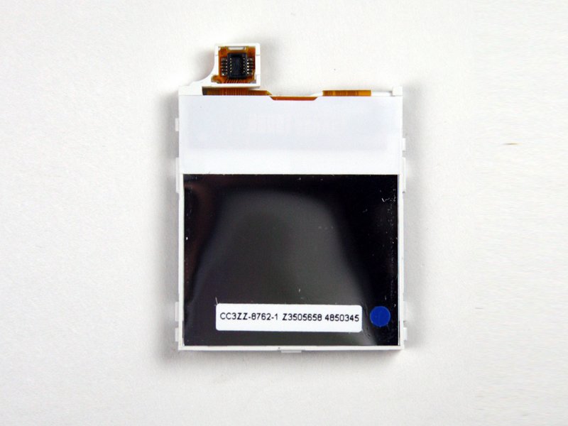

    1. Nokia 6560 Display Replacement, Display: step 8, image 1 of 2 Nokia 6560 Display Replacement, Display: step 8, image 2 of 2
      • Use the plastic opening tool to unmount the thin metal frame at the tab connections. You must do this on both sides.
      • Lift the thin metal frame off of the plastic frame.
      • Pay attention while lifting the frame off because it can easily be bent.
      Ask FixBot
    2. Nokia 6560 Display Replacement: step 9, image 1 of 3 Nokia 6560 Display Replacement: step 9, image 2 of 3 Nokia 6560 Display Replacement: step 9, image 3 of 3
      • Pull the sides of the plastic frame apart in order to loosen the display.
      • Take the display out of the plastic frame.
