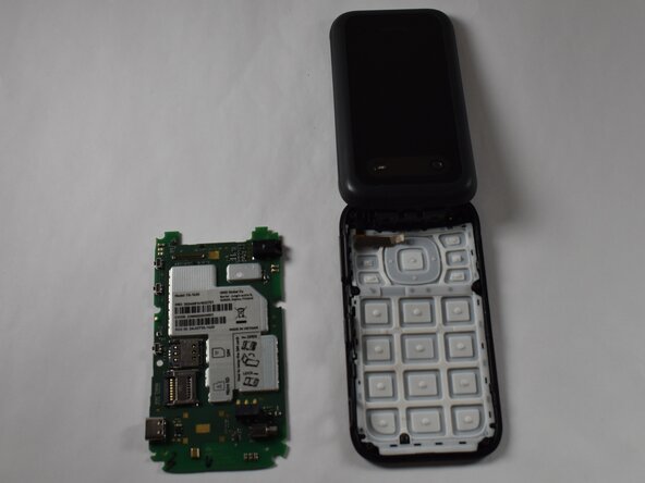

    5. Nokia 2780 Flip Screen Replacement: step 8, image 1 of 3 Nokia 2780 Flip Screen Replacement: step 8, image 2 of 3 Nokia 2780 Flip Screen Replacement: step 8, image 3 of 3
      • Pull back the frame surrounding the motherboard from both sides and gently remove the motherboard.
