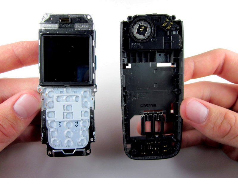

    1. Nokia 2610 Circuit Board Replacement, Circuit Board: step 6, image 1 of 1
      • Use the Torx screwdriver with the T6 attachmet to remove the 6 .4 mm screws around the outside of the circuit board.
      • Note: Removing the 4 T6 screws around the screen will loosen it, so don't worry if the screen also separates from the circuit board.
      Ask FixBot
    2. Nokia 2610 Circuit Board Replacement: step 7, image 1 of 3 Nokia 2610 Circuit Board Replacement: step 7, image 2 of 3 Nokia 2610 Circuit Board Replacement: step 7, image 3 of 3
      • Lift the circuit board out of the back cover.
