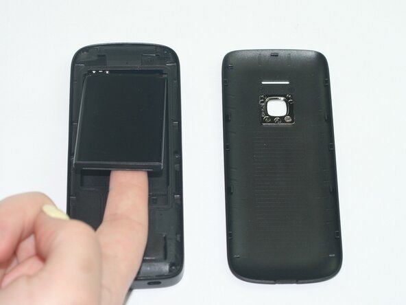

      • Insert an iFixit opening pick into the seam along the bottom edge of the phone’s back cover.
      • Slide the pick around the edges of the cover to release the retaining clips.
      • Remove the back casing to expose the battery.

      • Remove the battery by lifting it from the edge near the microSD card slot.
      • Install the battery, ensuring the metal contacts align with the connector at the bottom right of the compartment.
