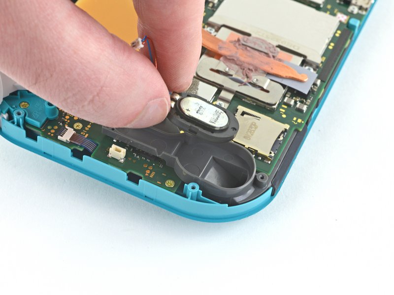

    4. Nintendo Switch Lite Right Speaker Replacement: step 17, image 1 of 3 Nintendo Switch Lite Right Speaker Replacement: step 17, image 2 of 3 Nintendo Switch Lite Right Speaker Replacement: step 17, image 3 of 3
      • Insert a spudger into the gap at the top of the speaker.
      • Take care to avoid the speaker wires as you insert the spudger into the gap.
      • Pry the speaker up to lift it out of its recess.
      • The speaker is adhered with light adhesive inside the speaker module, so a bit of force is required.
      • Remove the right speaker.
