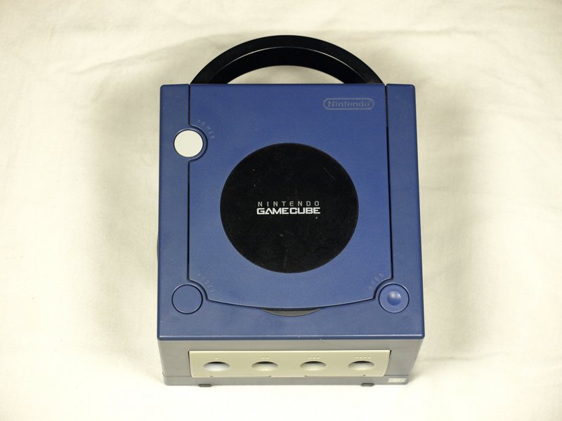

Removing the top case will allow you access to the GameCube's internal parts.
    1. Nintendo GameCube Top Case Replacement, Top Case: step 1, image 1 of 3 Nintendo GameCube Top Case Replacement, Top Case: step 1, image 2 of 3 Nintendo GameCube Top Case Replacement, Top Case: step 1, image 3 of 3
      • Turn over the Gamecube so that the bottom side is facing up.
      • Use the 4.5 mm Gamebit screwdriver to remove all four screws.
      Ask FixBot
    2. Nintendo GameCube Top Case Replacement: step 2, image 1 of 3 Nintendo GameCube Top Case Replacement: step 2, image 2 of 3 Nintendo GameCube Top Case Replacement: step 2, image 3 of 3
      • With the bottom side of the GameCube facing upward and the screws removed, carefully pull the outer shell of the unit away from the top half.
      • Move the GameCube so that the inside is facing upwards.
