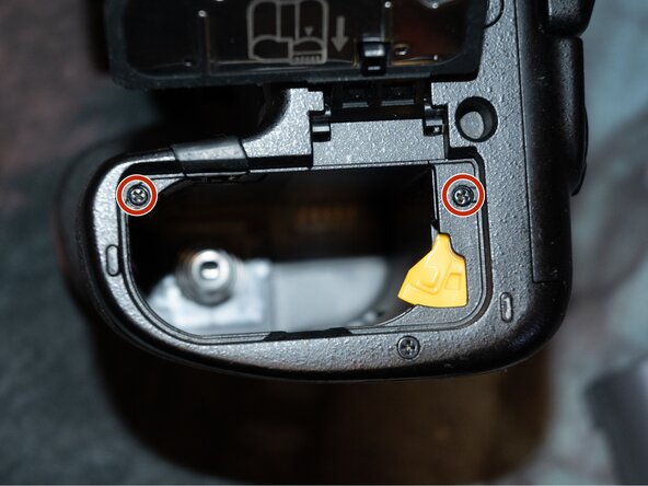

    3. Nikon D850 Main Imaging Board Replacement, Remove the baseplate: step 3, image 1 of 2 Nikon D850 Main Imaging Board Replacement, Remove the baseplate: step 3, image 2 of 2
      • Remove the 9 J00 screws holding the baseplate to the camera body
      • There are 2 sneaky screws under the battery compartment cover.

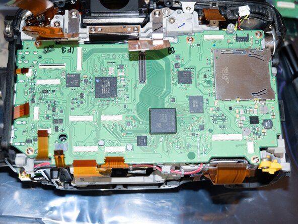

    8. Nikon D850 Main Imaging Board Replacement, Connector disconnection: step 8, image 1 of 3 Nikon D850 Main Imaging Board Replacement, Connector disconnection: step 8, image 2 of 3 Nikon D850 Main Imaging Board Replacement, Connector disconnection: step 8, image 3 of 3
      • Time to get the connectors off the main board!
      • All the connectors with red arrows are the same style as the rear cover connector. Flip up the latch at the rear of the connector and the cable will come out easily.
      • The blue connector is the main image sensor connector. It pulls straight up off the board "like a little lego".
      • The purple connector is easiest to remove by placing tweezers under the connector where the wires come out, and prying straight up. It comes out vertically but is "clipped" in.
      • These yellow guys are the dangerous ones. They press into the connector from the side without a latch. The cables have small "ears" on them to help pull them out and insert them but use extreme care removing these cables from the board. They require some force to remove from the connectors.
      • The connectors on the upper left and lower right are layered. Be sure to reconnect the new mainboard to the cables in the correct order!

    9. Nikon D850 Main Imaging Board Replacement, Mainboard Removal: step 9, image 1 of 1
      • Remove the 5 J00 screws around the edge of the mainboard. The mainboard will lift straight up and to the right out of the camera body.
