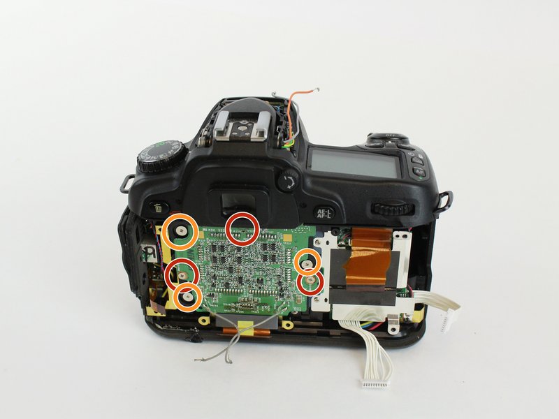

    1. Nikon D80 Motherboard Replacement, Motherboard: step 7, image 1 of 3 Nikon D80 Motherboard Replacement, Motherboard: step 7, image 2 of 3 Nikon D80 Motherboard Replacement, Motherboard: step 7, image 3 of 3
      • Unscrew the three 2.3 mm screws using a Phillips #00 screwdriver.
      • Use the Phillips #00 screwdriver to unscrew the three 4.7 mm screws.
      • Gently remove the motherboard.
