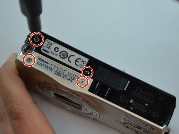

      • Using a Phillips #000 screwdriver, remove the two 3.1 mm screws on the side chrome bar on the left side of the camera (with the screen facing you).

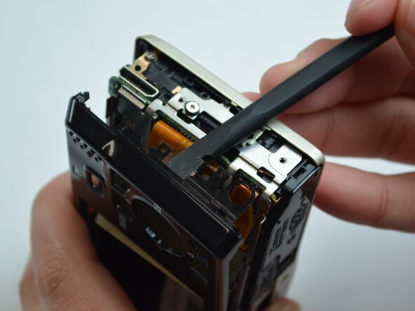

    3. Nikon Coolpix s6000 Camera Lens Replacement: step 3, image 1 of 2 Nikon Coolpix s6000 Camera Lens Replacement: step 3, image 2 of 2
      • Using the small plastic spudger, remove the edge piece that surrounds the shutter button off of the camera.
      • Remove the large chrome bar connected to the shutter button positioned on top of the camera.
      • Apply significant force into removing this piece.

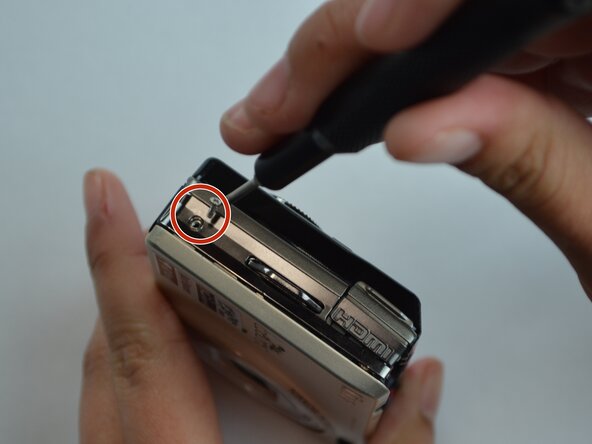

      • Using the Phillips #000 screwdriver, remove the two 3.9 mm screws from the chrome bar on the right side of the camera (with the screen side facing you).

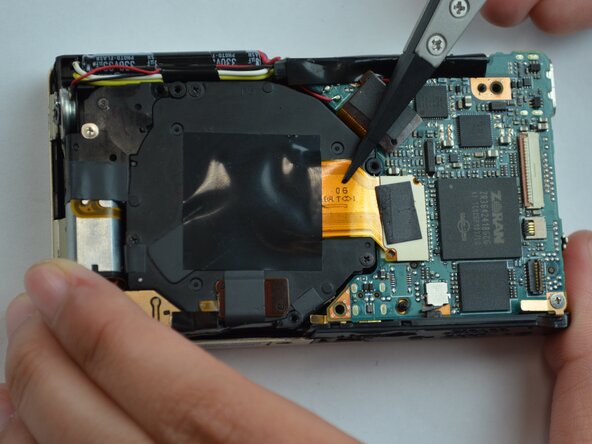

    1. Nikon Coolpix s6000 Camera Lens Replacement, Camera Lens: step 11, image 1 of 3 Nikon Coolpix s6000 Camera Lens Replacement, Camera Lens: step 11, image 2 of 3 Nikon Coolpix s6000 Camera Lens Replacement, Camera Lens: step 11, image 3 of 3
      • Using the Phillips #000 screwdriver, remove the five 3.6 mm screws from the motherboard covering.
      • With your fingers, carefully remove the cover.
      Ask FixBot
    2. Nikon Coolpix s6000 Camera Lens Replacement: step 12, image 1 of 2 Nikon Coolpix s6000 Camera Lens Replacement: step 12, image 2 of 2
      • Using tweezers, remove the two ribbons that are holding the camera lens to the circuit board.
      Ask FixBot

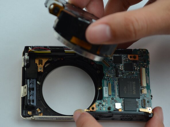

    3. Nikon Coolpix s6000 Camera Lens Replacement: step 13, image 1 of 2 Nikon Coolpix s6000 Camera Lens Replacement: step 13, image 2 of 2
      • Using your hands, gently remove the camera lens from the circuit board.
      Ask FixBot
