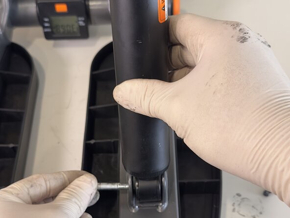

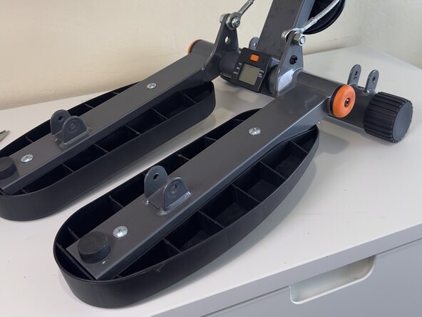

    • Flip the machine up and locate the hydraulic cylinder.
    Ask FixBot
  2. NiceDay Mini Stair Stepper Tension Cable Replacement: step 2, image 1 of 1
    • Locate 4 M6 x 45mm Allen Bolt.
    Ask FixBot
  3. NiceDay Mini Stair Stepper Tension Cable Replacement: step 3, image 1 of 3 NiceDay Mini Stair Stepper Tension Cable Replacement: step 3, image 2 of 3 NiceDay Mini Stair Stepper Tension Cable Replacement: step 3, image 3 of 3
    • One hand uses needle-nose pliers to hold the nut securely in place, while the other hand uses a 5mm hex key to unscrew the screw(counter-clockwise).
    Ask FixBot
  4. NiceDay Mini Stair Stepper Tension Cable Replacement: step 4, image 1 of 3 NiceDay Mini Stair Stepper Tension Cable Replacement: step 4, image 2 of 3 NiceDay Mini Stair Stepper Tension Cable Replacement: step 4, image 3 of 3
    • Remove this side of hydraulic cylinder and the M6 x 45mm Allen Bolt screw.
    • Repeat the process for the other side.

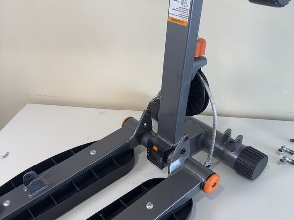

  7. NiceDay Mini Stair Stepper Tension Cable Replacement: step 7, image 1 of 2 NiceDay Mini Stair Stepper Tension Cable Replacement: step 7, image 2 of 2
    • The mini stair stepper will now resemble the image provided.
    • Separate 4 M6 x 45mm Allen Bolt and hydraulic cylinder in a designated area.

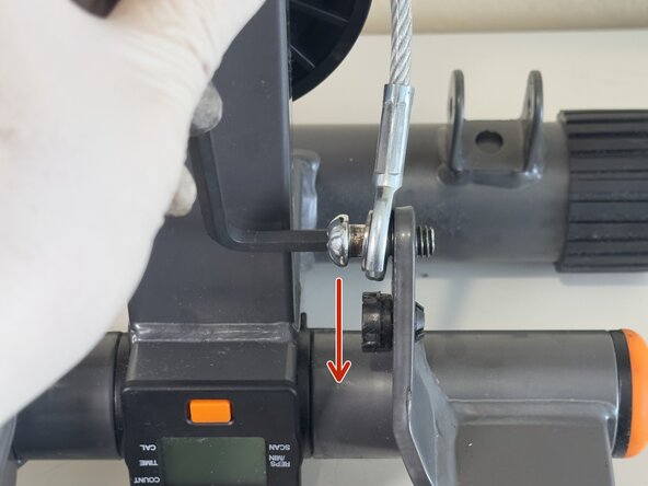

  8. NiceDay Mini Stair Stepper Tension Cable Replacement: step 8, image 1 of 1
    • Turn the machine so that the display is facing you.
    • Locate the 2 M8 x 16mm Allen Bolts that connect to the tension cable.
    Ask FixBot

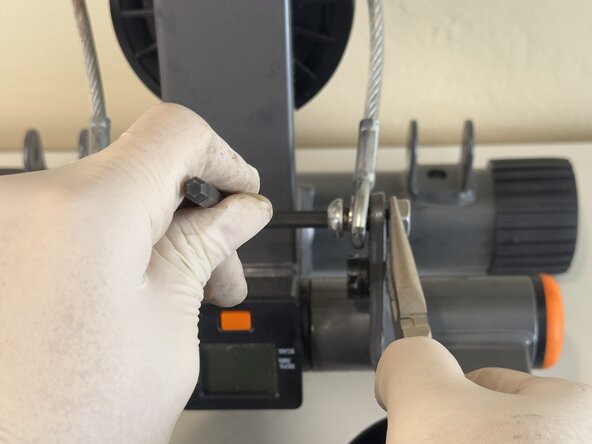

  9. NiceDay Mini Stair Stepper Tension Cable Replacement: step 9, image 1 of 3 NiceDay Mini Stair Stepper Tension Cable Replacement: step 9, image 2 of 3 NiceDay Mini Stair Stepper Tension Cable Replacement: step 9, image 3 of 3
    • With one hand, hold the nut using needle-nose pliers and with the other hand use a 6mm hex key to open the bolt (clockwise).
    Ask FixBot
  10. NiceDay Mini Stair Stepper Tension Cable Replacement: step 10, image 1 of 3 NiceDay Mini Stair Stepper Tension Cable Replacement: step 10, image 2 of 3 NiceDay Mini Stair Stepper Tension Cable Replacement: step 10, image 3 of 3
    • Remove the nut first.
    • Keep turning the bolt until it’s completely out.
    • Take out the cable on this side of the pedal.
    • Repeat the process for the other side of the pedal.

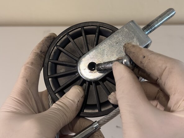

  14. NiceDay Mini Stair Stepper Tension Cable Replacement: step 14, image 1 of 3 NiceDay Mini Stair Stepper Tension Cable Replacement: step 14, image 2 of 3 NiceDay Mini Stair Stepper Tension Cable Replacement: step 14, image 3 of 3
    • Use needle-nose pliers to hold the nut still, and with your other hand, use a 6 mm hex key to loosen the bolt.
    • When you have the hold of the wheel in your hands, you can lift it off the ground to make it easier to open.
    Ask FixBot

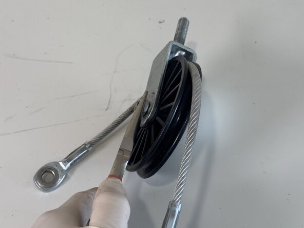

  15. NiceDay Mini Stair Stepper Tension Cable Replacement: step 15, image 1 of 3 NiceDay Mini Stair Stepper Tension Cable Replacement: step 15, image 2 of 3 NiceDay Mini Stair Stepper Tension Cable Replacement: step 15, image 3 of 3
    • Remove the nut and the wheel from the tension cable.
    Ask FixBot
  16. NiceDay Mini Stair Stepper Tension Cable Replacement: step 16, image 1 of 1
    • Separate the bolts from the hydraulic cylinder.
    • This will make it easier to reassemble.

  17. NiceDay Mini Stair Stepper Tension Cable Replacement: step 17, image 1 of 2 NiceDay Mini Stair Stepper Tension Cable Replacement: step 17, image 2 of 2
    • Wrap the new tension cable around the wheel.
    Ask FixBot
