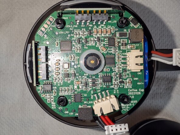

    2. NextMug coffee mug Battery Replacement: step 2, image 1 of 1
      • After carefully prying the bottom off, being careful to not damage the seal around the edge of the bottom case, we get our first look at the inner workings. In this photo I have already disconnected the battery and the heating element wires from the main board. There is a tiny ribbon cable that i was not able to disconnect, but it wasn't necessary.

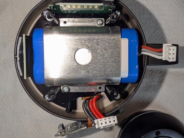

    3. NextMug coffee mug Battery Replacement: step 3, image 1 of 1
      • After carefully lifting the main board and letting it hang over the side by the ribbon cable, we have access to the battery and it's hold down bracket.
      Ask FixBot
    4. NextMug coffee mug Battery Replacement: step 4, image 1 of 1
      • The battery pack after removing it from the mug. Using the part number, search your favorite sources for a replacement. Assembly is the reverse of disassembly.
