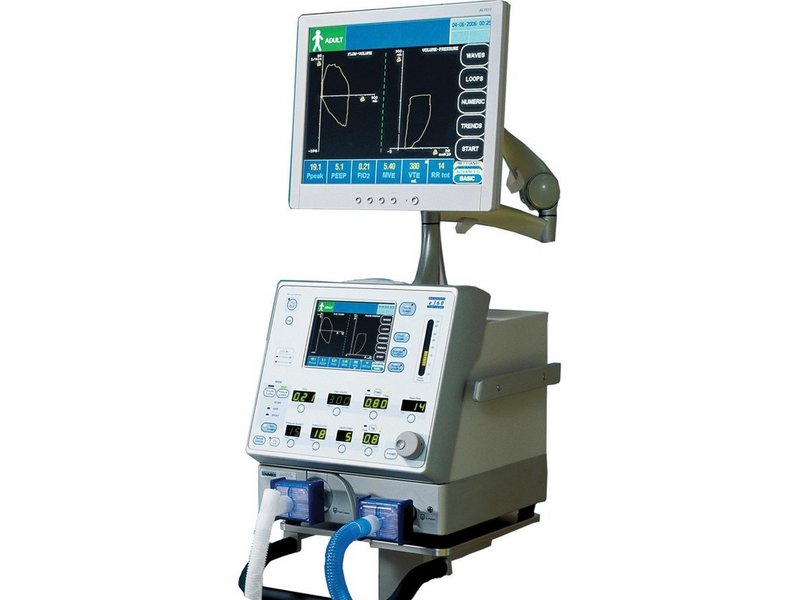

Before starting this repair, make sure that you have 30-45 minutes set side in case any problems are ran into despite the estimated replacement time of 10 minutes. Also, make sure that you have all of the right equipment available including a reusable circuit if the oxygen sensor is difficult to remove.
For more information on replacing the oxygen sensor, please refer to page 4-19 in the service manual.

    1. Newport e360 Oxygen Sensor  Replacement, Oxygen Sensor: step 1, image 1 of 1
      • Turn off ventilator before starting this repair.
      • Shut off or disconnect the air and oxygen gas supplies before starting this repair.
