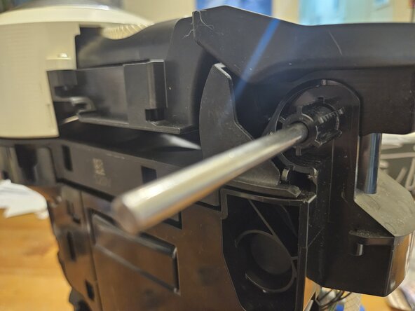

  6. Nespresso Vertuo Next Pod holder , barcode reader and drain pipe Replacement, Remove the Springs and pivot rod: step 6, image 1 of 3 Nespresso Vertuo Next Pod holder , barcode reader and drain pipe Replacement, Remove the Springs and pivot rod: step 6, image 2 of 3 Nespresso Vertuo Next Pod holder , barcode reader and drain pipe Replacement, Remove the Springs and pivot rod: step 6, image 3 of 3
    • Eye protection is recommended here, even though the springs are quite gentle. Remove them from their grooves and take note of their orientation. I found this is easier to do with the lid shut. Removing the bottom leg first then working the spring out to the side
    • Knock the pivot rod loose using a hammer and punch. A small thin screwdriver will also work here. If you lay the machine on its side it will ease the pressure off the rod and make removal easier
    • Unless you want to spend time disconnecting all the wires, just be careful when you move the machine around and you shouldn't have to disconnect anything else from the top of the machine

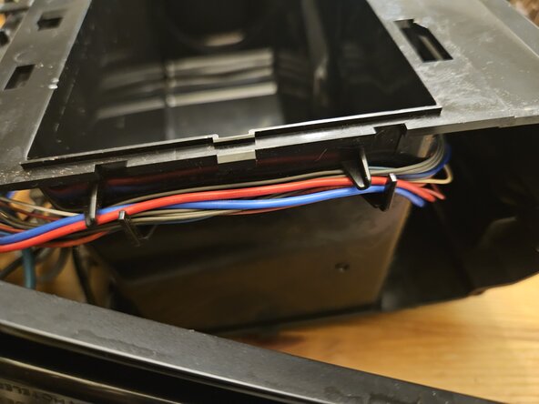

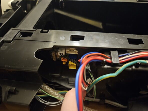

  9. Nespresso Vertuo Next Pod holder , barcode reader and drain pipe Replacement, Unplug the wires from rear panel panel: step 9, image 1 of 3 Nespresso Vertuo Next Pod holder , barcode reader and drain pipe Replacement, Unplug the wires from rear panel panel: step 9, image 2 of 3 Nespresso Vertuo Next Pod holder , barcode reader and drain pipe Replacement, Unplug the wires from rear panel panel: step 9, image 3 of 3
    • Unplug the wires at the back of the machine that run towards the bottom and up into the front of the machine. Then remove the wires from the tabs that hold them in place along the rear and bottom of the machine
    • With the wires free we can finally remove the front assembly
    • The plugs are all different sizes so its hard to mix up the connections. Reassembly should be a breeze

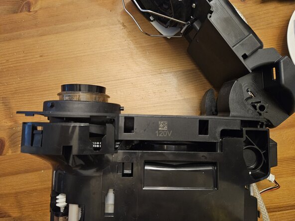

  10. Nespresso Vertuo Next Pod holder , barcode reader and drain pipe Replacement, Remove the pod holder assembly: step 10, image 1 of 3 Nespresso Vertuo Next Pod holder , barcode reader and drain pipe Replacement, Remove the pod holder assembly: step 10, image 2 of 3 Nespresso Vertuo Next Pod holder , barcode reader and drain pipe Replacement, Remove the pod holder assembly: step 10, image 3 of 3
    • Another two t8 torx security screws hold the top of the assembly in place
    • Make sure all the wires are disconnected and the drain pipe is unplugged from beside the spout motor as well as its drain slot which drains into the waste basket
    • With all the clearance we have from unhinging the top of the nespresso you should be able to lift the assembly up and outquite easily

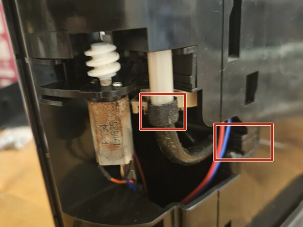

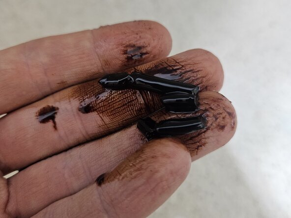

  11. Nespresso Vertuo Next Pod holder , barcode reader and drain pipe Replacement, Removing the drain pipe and cleaning: step 11, image 1 of 2 Nespresso Vertuo Next Pod holder , barcode reader and drain pipe Replacement, Removing the drain pipe and cleaning: step 11, image 2 of 2
    • The drain pipe accumulates coffee grime over time as it drains from the spout as well as from around the pod holder, should there be overflow. Now is a good time to clean it. It simply pulls away from the assembly
    • In my case the pipe was clogged solid. Gently breaking apart the stiff bits inside then soaking the pipe in hot water with vingar and baking soda should loosen the blockage. In my case I repeated the soak process 3-4 times
    • Use your hands to squeeze the blockage from the pipe. Avoid using a screwdriver here or other sharp object to avoid piercing the pipe

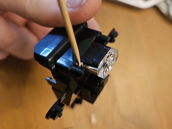

  12. Nespresso Vertuo Next Pod holder , barcode reader and drain pipe Replacement, Remove the barcode reader and its associated electronics: step 12, image 1 of 3 Nespresso Vertuo Next Pod holder , barcode reader and drain pipe Replacement, Remove the barcode reader and its associated electronics: step 12, image 2 of 3 Nespresso Vertuo Next Pod holder , barcode reader and drain pipe Replacement, Remove the barcode reader and its associated electronics: step 12, image 3 of 3
    • The barcode reader is connected by one set of wires and another two torx t8 security screws. You can also remove the lens for cleaning if it is dirty but be careful as the clips are very fragile.
    • you can unplug the connector but its not really necessary. Beyond that the board is held on with two tabs on the left and right if you wish to take a peek at the barcode reader sensors. There is plastic light shroud in there too. Don't lose it
    • The best way to remove the clips is to slip a toothpic towards the bottom. If you do break one of the clips I found that the lens will stay in place with just one clip but your milage may vary

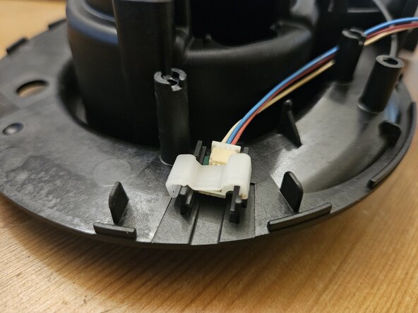

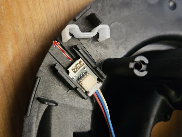

  13. Nespresso Vertuo Next Pod holder , barcode reader and drain pipe Replacement, Remove the lid closed sensor: step 13, image 1 of 3 Nespresso Vertuo Next Pod holder , barcode reader and drain pipe Replacement, Remove the lid closed sensor: step 13, image 2 of 3 Nespresso Vertuo Next Pod holder , barcode reader and drain pipe Replacement, Remove the lid closed sensor: step 13, image 3 of 3
    • I think this is a lid closed sensor but honestly am not sure, chatgpt suggested the little sensor is for IR but would love it if someone could confirm. Its held in with a a plastic clip. Again a toothpick under the clip hooks will work wonders here.
    • After the clip is removed the sensor can be slid out
    • I took the photos during reassembly rather than dissasembly so ignore the fact that the pod holder and motor are missing in the photos. We will remove them in the next steps
