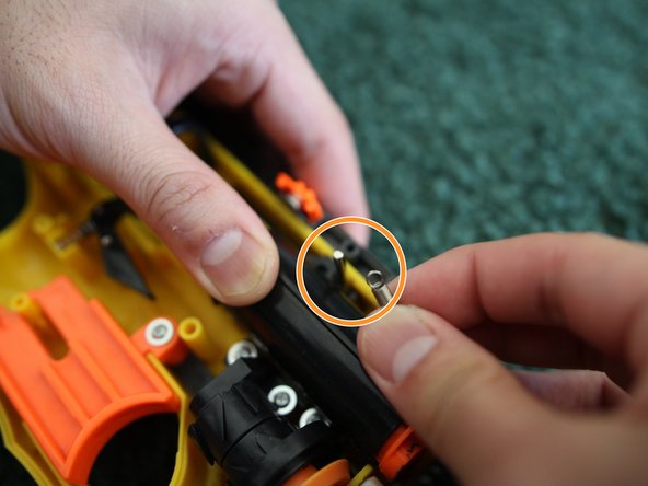

  5. Nerf N-Strike Maverick Trigger Repair: step 5, image 1 of 2 Nerf N-Strike Maverick Trigger Repair: step 5, image 2 of 2
    • Remove the screw holding the trigger to the body.
    • When screwing everything back together, remember to re hook the trigger spring.

  7. Nerf N-Strike Maverick Trigger Repair: step 7, image 1 of 2 Nerf N-Strike Maverick Trigger Repair: step 7, image 2 of 2
    • After examining and fixing the chassis, screw the trigger back onto the body.
    • Hook the upper spring to the metal rod.

  8. Nerf N-Strike Maverick Trigger Repair: step 8, image 1 of 3 Nerf N-Strike Maverick Trigger Repair: step 8, image 2 of 3 Nerf N-Strike Maverick Trigger Repair: step 8, image 3 of 3
    • Replace the outer shell of the Maverick and the top left screw.
    • When reattaching the outer shell, make sure to hold the top left piece as shown in the first picture. This ensures that the spring remains connected to the rod.
    • Screw the top left piece back onto the Maverick.
    • Replace the 10 screws on the Maverick.
