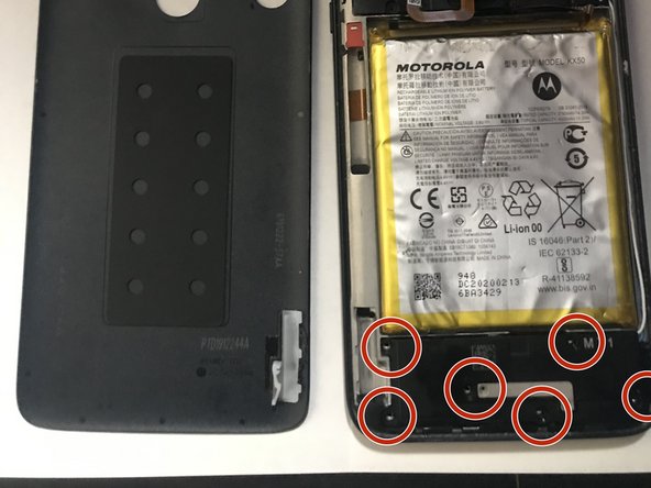

  4. Motorola g stylus battery Replacement, top and botttom inside covers: step 4, image 1 of 2 Motorola g stylus battery Replacement, top and botttom inside covers: step 4, image 2 of 2
    • Here you will have 15 t4 screws on top and bottom to take out but be careful with the top cover because the finger sensor runs under it. You don't want to rip that
  5. Motorola g stylus battery Replacement, Removing the battery: step 5, image 1 of 1
    • Here we need to be careful that we don't damage the battery, so unhook the battery and its flex cable. Then carefully get one corner of the battery lifted up to where you can get a good grip to pull on it. You will have to pull it slower so you don't damage the battery once that is done you made it.
