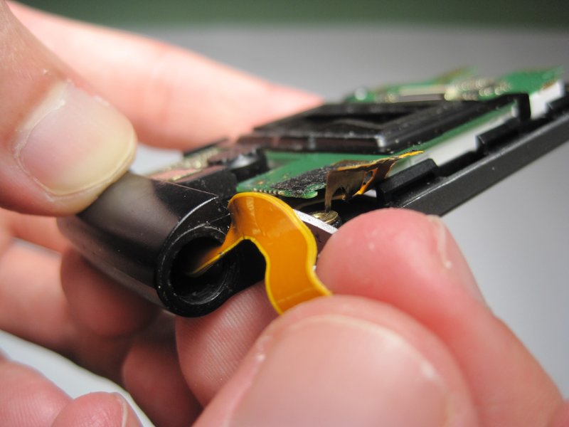

    7. Motorola V276 Flex Cable Replacement: step 15, image 1 of 1
      • Slide the ribbon cable through the tiny slit located in the hole on the side of the frame.
      Ask FixBot
