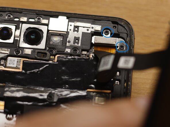

    2. Motorola Razr 2024 Front Screen Replacement, Remove CLI BTB Bracket: step 2, image 1 of 2 Motorola Razr 2024 Front Screen Replacement, Remove CLI BTB Bracket: step 2, image 2 of 2
      • Remove these two screws that are securing the CLI BTB Bracket
      • Remove the CLI Display Module BtB Connector from the Main PCB by gently prying with a tweezers
