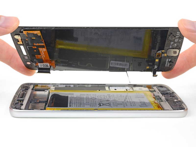

    17. Motorola Moto Z Play Screen Replacement: step 17, image 1 of 2 Motorola Moto Z Play Screen Replacement: step 17, image 2 of 2
      • Gently pull the fingerprint sensor cable to slide it out of its socket, disconnecting it from the motherboard.
      Ask FixBot
    18. Motorola Moto Z Play Screen Replacement: step 18, image 1 of 2 Motorola Moto Z Play Screen Replacement: step 18, image 2 of 2
      • Gently pull the display cable to slide it out of its socket on the motherboard.
      Ask FixBot
    19. Motorola Moto Z Play Screen Replacement: step 19, image 1 of 1
      • Remove the display assembly.
      Ask FixBot

    7. Motorola Moto Z Play Screen Replacement: step 40, image 1 of 2 Motorola Moto Z Play Screen Replacement: step 40, image 2 of 2
      • Before sealing the display in place, connect the flex cables for the display and fingerprint sensor, and then power your phone on.
      • Test all functions to make sure your repair was successful before sealing up the display.
      • When fully inserted, the white line across each flex cable should be even with the markings on the motherboard on each side of the cable.
      • Do not remove, insert, or adjust the cables while the phone is powered on.
      • The cables can be tricky to align and install. Be sure not to touch the gold contacts on the back, or your finger oils may cause a malfunction. If you do accidentally touch them, wipe them gently with isopropyl alcohol.
