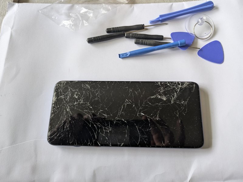

    1. Motorola Moto G100 Screen Replacement, Screen: step 1, image 1 of 1
      • Screen is broken. Buy replacement screen with prying tools and suction cup.
