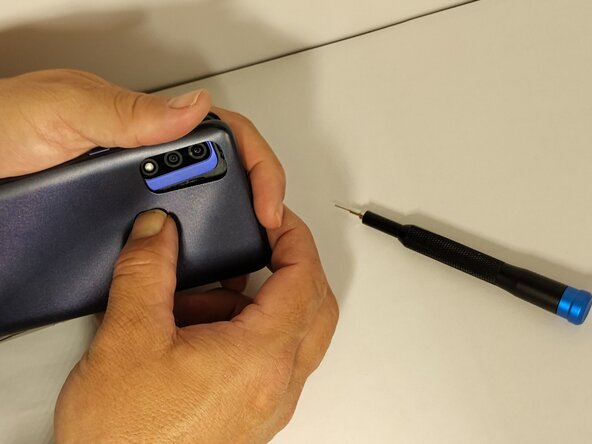

      • When disassembling the phone, the battery should be discharged below 20%.
      • Turn the phone off.
      • Use a SIM card eject tool to release the SIM card tray from the phone.
      • Use precision tweezers to remove the SIM Tray.

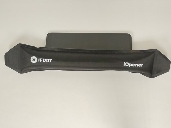

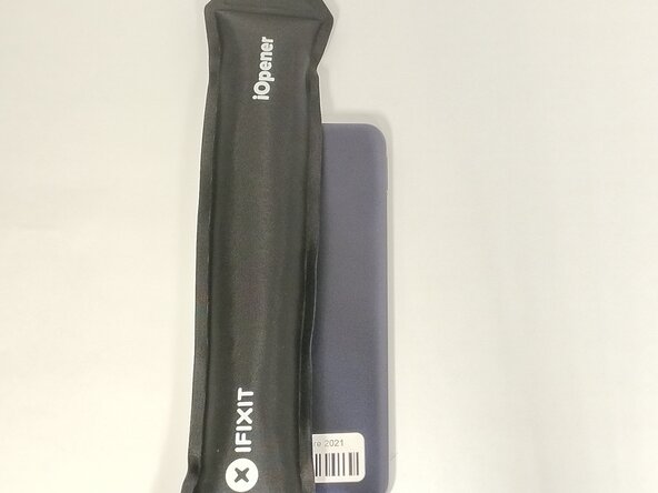

      • Use caution when handling the iOpener after heating.
      • Adhering to the instructions printed on the iOpener, heat the iOpener.
      • To soften the adhesive that holds the back cover to the screen, place the iOpener on the right side of the phone screen for 2 - 3 minutes.
      • Reheat the iOpener.
      • Place the iOpener on the left side of the phone for 2 - 3 minutes.

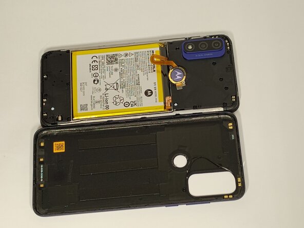

    7. Motorola Moto G Pure 2021 Back Cover Replacement: step 7, image 1 of 3 Motorola Moto G Pure 2021 Back Cover Replacement: step 7, image 2 of 3 Motorola Moto G Pure 2021 Back Cover Replacement: step 7, image 3 of 3
      • Remove the back cover.
