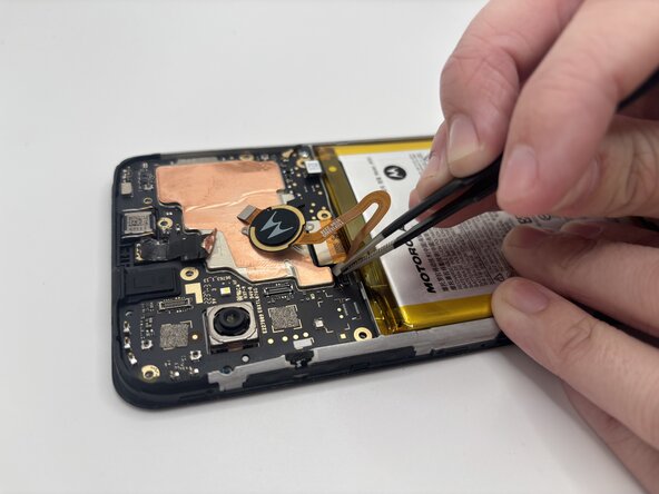

  7. Motorola Moto G Power 2022 Back Camera Replacement: step 7, image 1 of 2 Motorola Moto G Power 2022 Back Camera Replacement: step 7, image 2 of 2
    • Place a spudger or an opening tool under the edge of the fingerprint sensor connector and pry straight up to disconnect it.
    • Set it aside.

    • Use a Torx T5 screwdriver to remove one final 3.9 mm screw from right above the battery.
