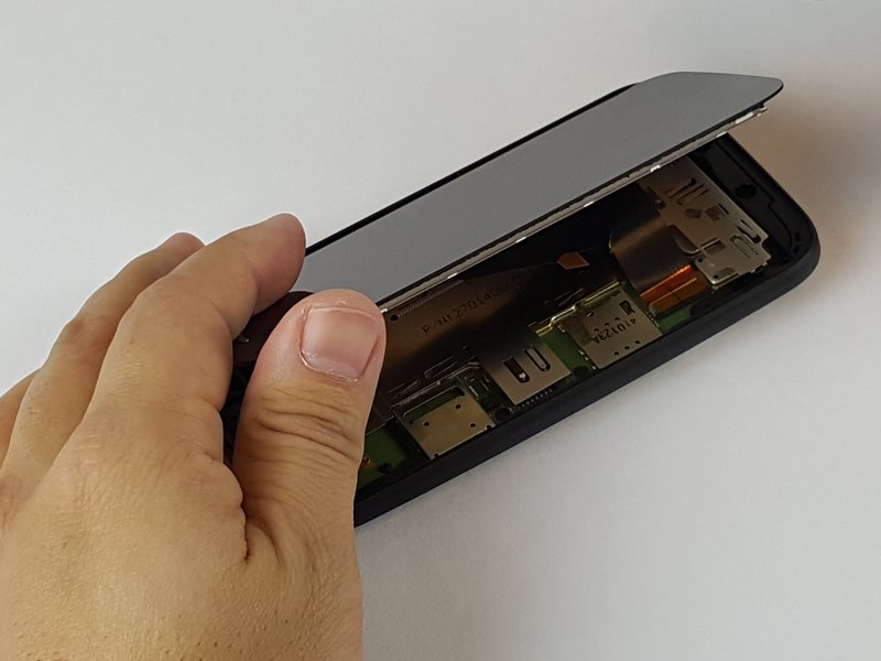

      • Using the small plastic opening tool, pry and slide all the way around the phone while carefully lifting up on the display.
      • The screen is secured by two-sided tape located on the edge.
      Ask FixBot
    3. Motorola Moto E 2nd Generation Display Assembly Replacement: step 3, image 1 of 3 Motorola Moto E 2nd Generation Display Assembly Replacement: step 3, image 2 of 3 Motorola Moto E 2nd Generation Display Assembly Replacement: step 3, image 3 of 3
      • Once display is fully unglued from the frame, carefully lift it up and locate the display connector.
      • Using the same small plastic tool, carefully remove the yellow tape off the connector.
      • Now carefully undo the black connector lock by lifting it up in the direction of the red arrow.
      • Do not pry on the gray part of the connector.
      • Lastly slide the display cable off the connector. It should easily slide off, if not make sure the black lock is fully unlatched.
