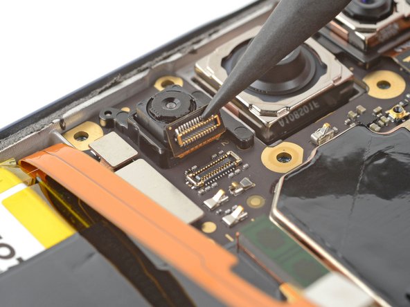

  20. Motorola Edge 5G UW (2022) Depth Camera Replacement, Disconnect the depth camera: step 20, image 1 of 2 Motorola Edge 5G UW (2022) Depth Camera Replacement, Disconnect the depth camera: step 20, image 2 of 2
    • Use the pointed end of a spudger to pry up and disconnect the depth camera's press connector.
