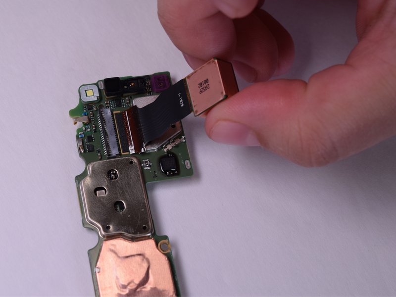

    11. Motorola Droid Turbo 2 Rear-Facing Camera Replacement: step 24, image 1 of 1
      • Using the pointed tweezers, remove the tape that covers the ZIF connector.
      Ask FixBot
    12. Motorola Droid Turbo 2 Rear-Facing Camera Replacement: step 25, image 1 of 1
      • Using the spudger, pry up the ZIF connector.
      Ask FixBot
    13. Motorola Droid Turbo 2 Rear-Facing Camera Replacement: step 26, image 1 of 1
      • Remove the rear-facing camera.
