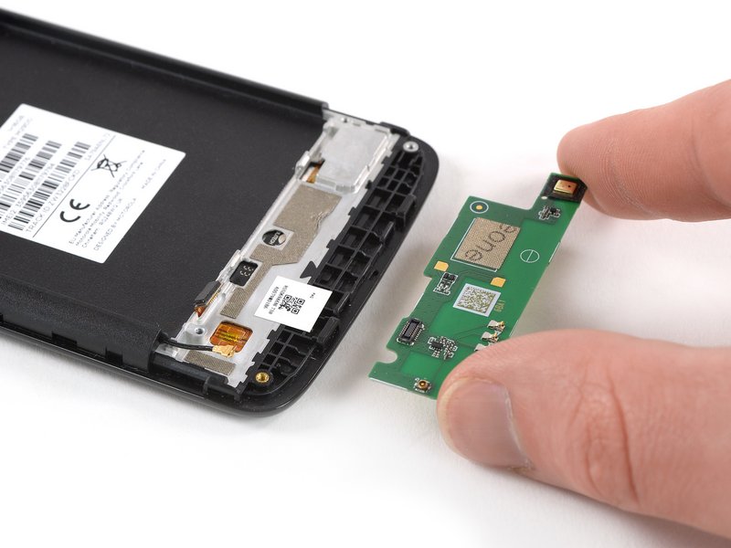

Use this guide to replace the daughterboard in the Motorola Moto C.

    1. Moto C Daughterboard Replacement, Daughterboard: step 7, image 1 of 2 Moto C Daughterboard Replacement, Daughterboard: step 7, image 2 of 2
      Tool used on this step:
      Buy
      • Use a pair of tweezers to disconnect the antenna cable on the left of the daughterboard.
      Ask FixBot
    2. Moto C Daughterboard Replacement: step 8, image 1 of 2 Moto C Daughterboard Replacement: step 8, image 2 of 2
      • Use a spudger to disconnect the digitizer flex cable on the upper left of the daughterboard.
      Ask FixBot
    3. Moto C Daughterboard Replacement: step 9, image 1 of 2 Moto C Daughterboard Replacement: step 9, image 2 of 2
      • Use a pair of tweezers to remove the rubber gasket that covers the microphone on the bottom right of the daughterboard.
      Ask FixBot
    4. Moto C Daughterboard Replacement: step 10, image 1 of 1
      • Prepare an iOpener and apply it to the bottom part of the display for at least two minutes to loosen the adhesive beneath the daughterboard.
      Ask FixBot
    5. Moto C Daughterboard Replacement: step 11, image 1 of 3 Moto C Daughterboard Replacement: step 11, image 2 of 3 Moto C Daughterboard Replacement: step 11, image 3 of 3
      • Apply an opening pick to the bottom right corner of the daughterboard.
      • Carefully slide the opening pick under the daughterboard to cut the adhesive underneath.
      • Slide the opening pick from right to left to cut all the adhesive.
      Ask FixBot
    6. Moto C Daughterboard Replacement: step 12, image 1 of 2 Moto C Daughterboard Replacement: step 12, image 2 of 2
      • Twist the opening pick to lift the daughterboard until you can get a good grip.
      • Remove the daughterboard.
      Ask FixBot
