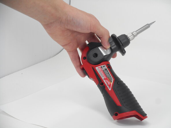

      • Remove the cover on the right side of the iron.
      Ask FixBot
    2. Milwaukee M12 Soldering Iron Fuse Replacement: step 2, image 1 of 3 Milwaukee M12 Soldering Iron Fuse Replacement: step 2, image 2 of 3 Milwaukee M12 Soldering Iron Fuse Replacement: step 2, image 3 of 3
      • Remove the two 13.7 mm-long screws using a TR15 Torx screwdriver.
      Ask FixBot

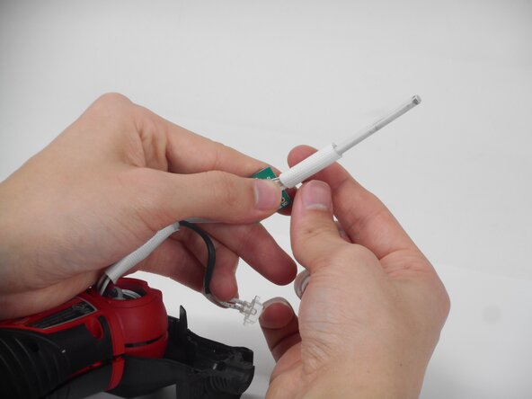

    3. Milwaukee M12 Soldering Iron Fuse Replacement: step 3, image 1 of 2 Milwaukee M12 Soldering Iron Fuse Replacement: step 3, image 2 of 2
      • Rotate the sleeve guard counter-clockwise to remove it.
      • Remove the knurled fastener.

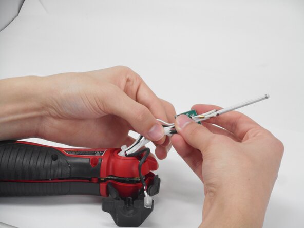

    4. Milwaukee M12 Soldering Iron Fuse Replacement: step 4, image 1 of 2 Milwaukee M12 Soldering Iron Fuse Replacement: step 4, image 2 of 2
      • Pry open the frame with a spudger to expose the internal components.
      Ask FixBot
    5. Milwaukee M12 Soldering Iron Fuse Replacement: step 5, image 1 of 3 Milwaukee M12 Soldering Iron Fuse Replacement: step 5, image 2 of 3 Milwaukee M12 Soldering Iron Fuse Replacement: step 5, image 3 of 3
      • Remove the thermal cover to expose the bottom thermal cover.
      • Push down the thermal cover that is covering the fuse.
      • If there isn't enough space to push down the thermal cover to expose the fuse, then locate the zip tie and the thermal cover and push them down into the compartment. This will provide more space to pull down the thermal cover where the fuse rests.
      Ask FixBot
    6. Milwaukee M12 Soldering Iron Fuse Replacement: step 6, image 1 of 1
      • Cut the fuse and leave enough wire to be able to solder the new fuse.
      Ask FixBot
