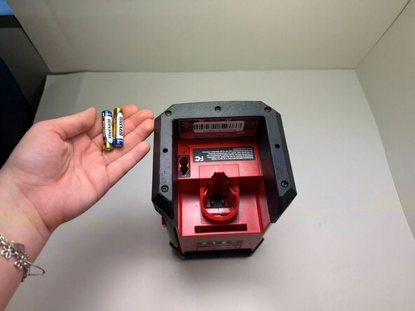

    2. Milwaukee M12 2951-20 Back Panel Removal: step 2, image 1 of 3 Milwaukee M12 2951-20 Back Panel Removal: step 2, image 2 of 3 Milwaukee M12 2951-20 Back Panel Removal: step 2, image 3 of 3
      • Use a Phillips #1 screwdriver to remove the 15mm screw securing the battery cover.
      • Remove the cover and set it aside.
      • Remove the two AAA batteries from the compartment.
