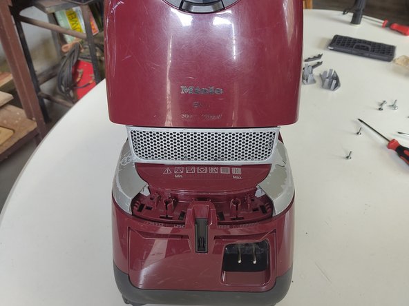

How do you disassemble a Miele S5 series vacuum cleaner, in my case an S5311?
    1. Miele S5311 Vacuum Cleaner Disassembly Guide, Vacuum cleaner: step 1, image 1 of 2 Miele S5311 Vacuum Cleaner Disassembly Guide, Vacuum cleaner: step 1, image 2 of 2
      • Open the cover, remove the dust bag and dust filter (already done here), and release the deep-seated screws (TX15).
      • Also release the two screws next to the grille.

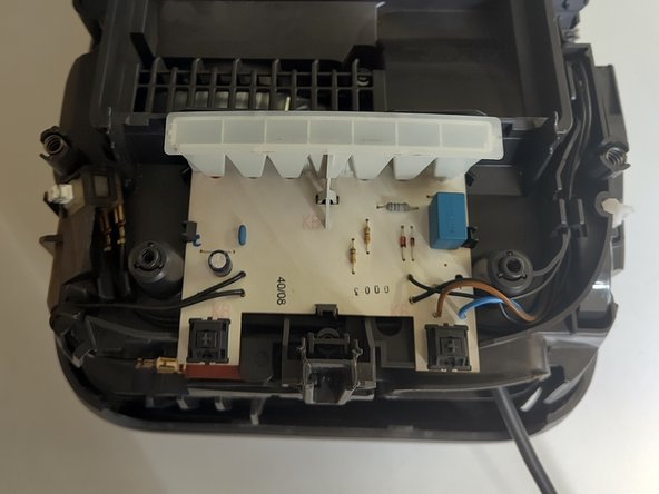

    3. Miele S5311 Vacuum Cleaner Disassembly Guide: step 3, image 1 of 2 Miele S5311 Vacuum Cleaner Disassembly Guide: step 3, image 2 of 2
      • Below this, the PCB with switches and LEDs becomes visible.
      • It can be pulled straight up - carefully remove it from the connector.
