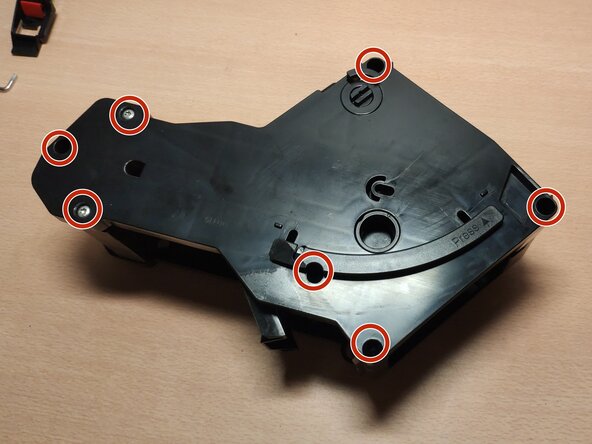

  4. Miele CM7 Coffee Maker - brew unit refresh, Open the brewing unit: step 4, image 1 of 3 Miele CM7 Coffee Maker - brew unit refresh, Open the brewing unit: step 4, image 2 of 3 Miele CM7 Coffee Maker - brew unit refresh, Open the brewing unit: step 4, image 3 of 3
    • Remove 7 * T15 screws, all the same.
    • Pull the upper body upward.
    • You are now with 8 screws: 1T10 (at left) for the handle, 7 T15 for the body.

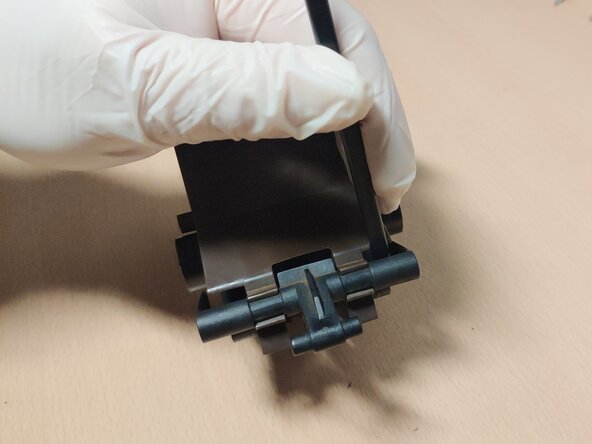

  6. Miele CM7 Coffee Maker - brew unit refresh, Dismantle the brewer: step 6, image 1 of 3 Miele CM7 Coffee Maker - brew unit refresh, Dismantle the brewer: step 6, image 2 of 3 Miele CM7 Coffee Maker - brew unit refresh, Dismantle the brewer: step 6, image 3 of 3
    • Unscrew the elbow part, remove it, change the O-Ring on the smaller part (the other O-Ring never move and shouldn't need a change!).
    • Using a robust, thin tool, apply pressure to extract the axle. It may pop up, please be ready for it.
    • Extract the lower filter.
    • Clean EVERY hole in the lower filter! I used the sharp metallic tool and the portable blower, a sewing needle and your mouth may do ;)
