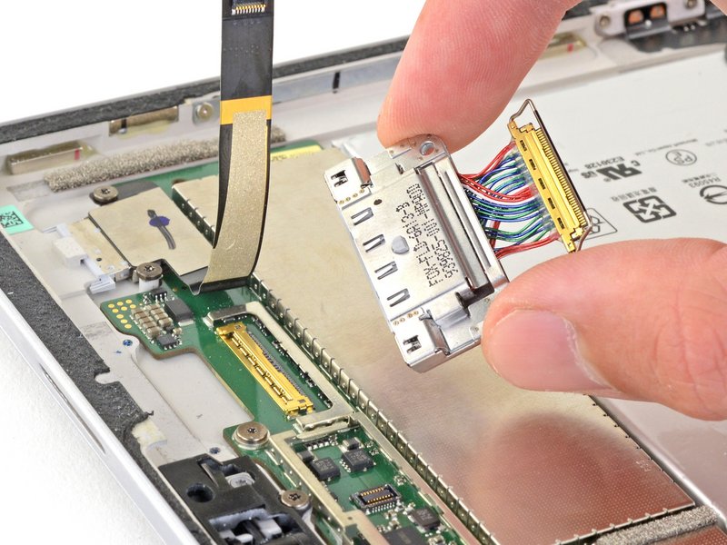

    1. Microsoft Surface Pro 4 Charging Asembly Replacement, Remove the charging assembly: step 23, image 1 of 2 Microsoft Surface Pro 4 Charging Asembly Replacement, Remove the charging assembly: step 23, image 2 of 2
      • Lift the microSD card reader cable up and out of the way of the EMI shield covering the charging assembly.
      • Only bend the cable as much as is necessary to access the EMI shield. Do not fold or bend the cable sharply.
      Ask FixBot
    2. Microsoft Surface Pro 4 Charging Asembly Replacement: step 24, image 1 of 3 Microsoft Surface Pro 4 Charging Asembly Replacement: step 24, image 2 of 3 Microsoft Surface Pro 4 Charging Asembly Replacement: step 24, image 3 of 3
      Tool used on this step:
      Buy
      • Insert one point of a pair of tweezers into a gap in the edge of the EMI shield covering the charging assembly cable connector.
      • Use the tweezers to pry the EMI shield away from the motherboard as much as you can without bending it.
      • Try not to deform the shield too much—you will need to reinstall it during reassembly.
      • Remove the shield.
      Ask FixBot
    3. Microsoft Surface Pro 4 Charging Asembly Replacement: step 25, image 1 of 2 Microsoft Surface Pro 4 Charging Asembly Replacement: step 25, image 2 of 2
      • Use the flat end of a spudger to flip up the retaining lock securing the charging assembly cable connector.
      Ask FixBot
    4. Microsoft Surface Pro 4 Charging Asembly Replacement: step 26, image 1 of 3 Microsoft Surface Pro 4 Charging Asembly Replacement: step 26, image 2 of 3 Microsoft Surface Pro 4 Charging Asembly Replacement: step 26, image 3 of 3
      • Use the tip of a spudger to carefully push on each side of the connector.
      • Alternating from one side to the other, gently "walk" the connector out of its socket.
      Ask FixBot
    5. Microsoft Surface Pro 4 Charging Asembly Replacement: step 27, image 1 of 1
      • Use a T5 Torx screwdriver to remove the two 3.7 mm screws securing the charging assembly.
      Ask FixBot
    6. Microsoft Surface Pro 4 Charging Asembly Replacement: step 28, image 1 of 3 Microsoft Surface Pro 4 Charging Asembly Replacement: step 28, image 2 of 3 Microsoft Surface Pro 4 Charging Asembly Replacement: step 28, image 3 of 3
      • Tilt the back of the charging assembly up to about a 30 degree angle and pull it straight back out of the chassis.
      Ask FixBot
